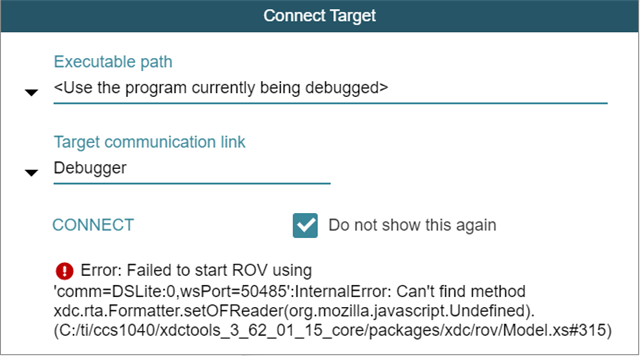

  • Hi Whitney,
    I am unable to get the ROV working, below is the error displayed
    #315 has the below line

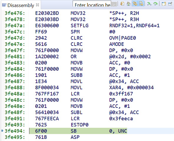

    And with InitPieVectTable() not being called, I cannot get past below line
    It gets stuck in below assembly code and does not execute my tasks

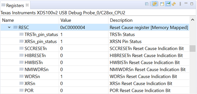

  • I think that address where you're ending up is in the boot ROM. You seem to be getting a reset. Can you look at the reset cause register (RESC) in the CCS Registers View and see what it says?
    Not sure what's going on with ROV. Can you try ROV Classic instead?
    Whitney
  • RESC is as shown below
    The Watchdog timer is causing the RESET.
    ROV Classic is working, what exactly should I be looking at in the ROV Classic to find the stack overflow?

    The code runs into bootROM, if InitPieVect() is not called.
