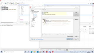

  • Hi Siddarth,
    Thanks for your reply. FInd below screenshot of my preferences showing CCS version and compiler.
    I think my previous laptop used the compiler 15 rather than 20. But I don't see why compiler 20 wouldn't be able to compile a previous version - I have tried a random ADC example with dual cores from the C2000 examples folder I have installed and they have compiled successfully.
    Here is the nonBIOS command file:

  • Hi Joel,
    The file F2837xD_Headers_nonBIOS_cpu1. cmd looks fine.
     Also , what is the optimization level that you are using for the compiler? You can try setting it to -o2 and see if it compiles.
    Best Regards
    Siddharth
  • Hi Siddharth,
    I actually have tried to run the optimisation software and every single level throws the same errors. I am lost for solutions.
  • Hi, Does anyone have any further suggestions regarding this issue?
