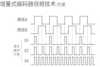

Which of the above counting methods is used for QEP modules?
X1 X2 or X4 ?
X1 X2 or X4 ?

thank you, Kelvin; i have found that code in hal.c writing :
QEP_set_QEP_source(obj->qepHandle[qep], QEP_Qsrc_Quad_Count_Mode);
so Instaspin adopt the Quadrature Count Mode;
