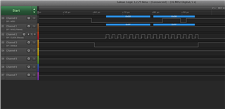

hi everyone
I am a beginner in the CCS area and I need help. I am trying to communicate between two f28379D launchpads with SPI. I want to send data from master to slave. However, the problem is coming. Everything is great in the master. I observed the waveform in the master with an oscilloscope.
but I am unable to receive the data on the slave side.
////////////////////////// master code ///////

/////////////////////////////////   output of the master
