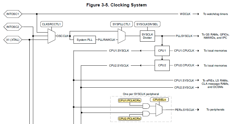

  • electrocc,
    Each CPU system has its own local PCLKCRx configuration. From the TRM:
    It sounds like CPU2 already has its PCLKCR13 enabled or else the ADC registers would not be accessible.
    -Tommy
  • tlee,
    In my software, I proceed like I described in my previous post. I didn't configured PCLKCR13 register on CPU2 and it seems to works.
    - Is it possible that even if the ADC conversion is started on CPU2, it's in reality CPU1 which is driving the conversion ?
    - How to be sure that CPU2 drives really the conversion ?
    Thanks for your support.
  • electrocc,
    What is your ADC trigger source?
    If you are reusing snippets of TI example software, it's likely that you are calling a function like InitSysCtrl() that enables all of the clocks in the system.
    The ADC configuration registers will only be accessible by one CPU for a given instance. You can verify the CPU assignment by reading back the configuration registers. The behavior is described in this other thread: https://e2e.ti.com/support/microcontrollers/c2000-microcontrollers-group/c2000/f/c2000-microcontrollers-forum/1032698/tms320f28377d-requirements-for-adcinltrim-and-adcofftrim-when-adc-is-controlled-by-cpu2/3829574#3829574
    -Tommy
