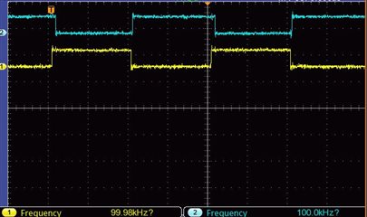

Dear Team,
I have the below doubts..pls clarify those.
1. I am generation 100khz pulse through pulse generator in Matlab but while I am seeing through GPIO pin in c2000 getting the pulse of 50 kHz.. using GPIO pin getting PWM pulse of half frequency....why?
for Epwm block for TBPRD calculation(Up-Down mode) while using TBCLK value as 100Mhz getting TBPRD values like 1000 for 50khz frequency and pulse also display same 50khz frequency from C2000 board. One more point, max frequency I can use 100mhz, not 200 MHz, pls confirm
Calculation like,
2. for GPIO pin... D1 and D2 signals are show PWM signals from the Delfino c2000 board. the first GPIO is GPIO19 and the second one is GPIO18. The frequency used (1/1e-05)=100KHz but in output getting as 50khz.
Pratyay

Hi Pratyay,
I tried the same model for GPIO Toggle. But I was able to see 100KHz frequency (see below picture)
Regarding the ePWM max frequency, you can set the following configuration option to switch between 100Mhz or 200Mhz.
For additional queries please connect directly to MathWorks' tech support.

OK ..For EPWM block i will check and let you know..
But for PWM through GPIO why its coming 50% for me ..any idea? Have you check with c2000 delfino board?
Pratyay

1. Now the EPWM block is working fine ...getting proper frequency.
2. But still through GPIO getting half of the expected frequency. could u please tell me where I am missing? coz circuit is simple ...any configuration I am missing?
if possible pls share ur model Xls file.
