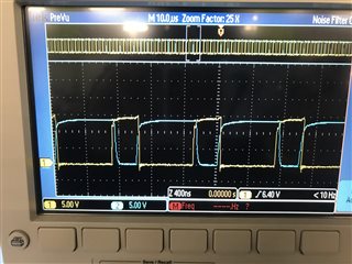

I am still having an issue in my C2000Ware code for the F2837xD device. When programming the dead-band modules of the PWM for EPWM 1 and EPWM 3, both outputs have overlapping PWM signals. I have attached such example photo of EPWM1 which uses HRPWM and has 1MHz output switching frequency:
As you can see there is clear overlap here. I was thinking it could be that my gate driver rise and fall times are not the best, however it looks like even the command to turn on/turn off are overlapping, so it is most likely still a code problem as well. Here is my PWM set up for channel A/B of PWM1 module:

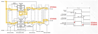

EPwm1Regs.DBCTL.bit.OUT_MODE = 3; // Fully enable dead-band for both falling and rising-edges
EPwm1Regs.DBCTL.bit.POLSEL = 2; // Active High Complimentary (AHC) Mode
//EPwm1Regs.DBFEDHR.bit.DBFEDHR = FLY_DEADTIME; // Set dead-time for falling edge
//EPwm1Regs.DBREDHR.bit.DBREDHR = FLY_DEADTIME; // Set dead-time for rising edge /* BEEN CHANGED BY JM HOLLAND */ TO HR BITS
EPwm1Regs.DBFED.bit.DBFED = FLY_DEADTIME;
EPwm1Regs.DBRED.bit.DBRED = FLY_DEADTIME;

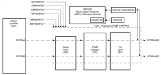

// High Resolution Pulse Width Modulator Definitions
EPwm1Regs.HRCNFG.all = 0x0; // Clear all bits first within the HRCNFG register
EPwm1Regs.HRCNFG.bit.EDGMODE = 0x3; // Control both falling and rising edge delays with the MEP
EPwm1Regs.HRCNFG.bit.CTLMODE = 0x0; // CMPAHR controls the MEP
EPwm1Regs.HRCNFG.bit.HRLOAD = 0x0; // Shadow load on CTR = Zero for count-up mode
EPwm1Regs.HRCNFG.bit.AUTOCONV = 1; // Enable auto-conversion logic
EPwm1Regs.HRPCTL.bit.HRPE = 0; // Turn off high-resolution period control

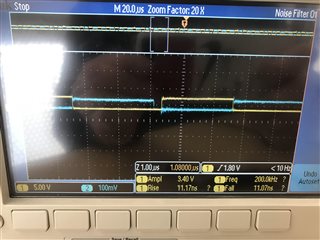

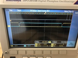

Is there anything blatantly wrong with this code above? The PRD is 199, and dead-time is 8 so about 40nS for a 1uS period. I have tried smaller dead-times to no avail, facing the same issues.

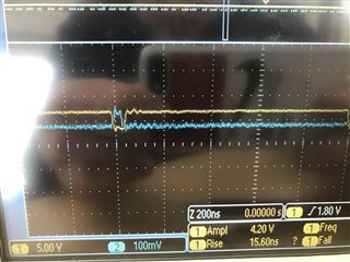

Any advice is appreciated, and any other information I can provide I will do so happily. Here's a closer look at the signals;
