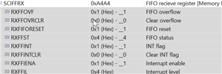

Hi Expert,
My customer are facing an issue that SCI receive overflow and SciaRegs.SCIFFRX.bit.RXFFOVF is 1, but sometimes did not go to the interrupt.
as the TRM mention, when SCI receive overflow occur, there should be able to go to the interrupt.
I did the test with control card and modified the code from c2000ware as below, when set overflow_test=1 in ccs windows, there will not read data and will cause receive data overflow:
in sciaRxFifoIsr also reset the SCI according to flag SciaRegs.SCIFFRX.bit.RXFFOVF.
sciaRxFifoIsr(void)
    Uint16 i;
    if(SciaRegs.SCIFFRX.bit.RXFFOVF ==1)
         overflow_test = 0;
         SciaRegs.SCICTL1.all = 0x0023;
         SciaRegs.SCIFFTX.bit.TXFIFOXRESET = 1;
         SciaRegs.SCIFFRX.bit.RXFIFORESET = 1;
         overflow_count++;
    if(overflow_test ==0)
        for(i=0;i<1;i++)
            rdataA[i]=SciaRegs.SCIRXBUF.all;  // Read data
Just set overflow_test to 1 and see the result, did the test several times will find that, SciaRegs.SCIFFRX.bit.RXFFOVF is 1, but did not enter the interrupt sciaRxFifoIsr  again.
Anything wrong here? why would have case that SciaRegs.SCIFFRX.bit.RXFFOVF is 1 but the code did not run to sciaRxFifoIsr  ?

    What is the value of RXFFIL? Can you also check the value of RXFFST to see if there data in the RX Buffer?
    In the screenshot you attached, overflow_count is equal to 1 (seen in the expressions window), is it initially 0? This would mean that the ISR was entered and its value was increased.

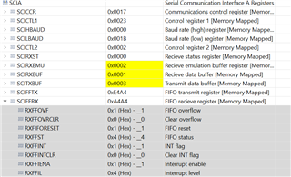

  • Hi Marlyn,
    Sorry I forgot to attach the code.
    at the beginning, overflow_test is 0, when set it to 1 in CCS window, there will trigger overflow,
    If the code run to ISR when overflow occur, then overflow_count  value will increase, which means it work as expected.
    otherwise there will no changed, which means the code did not run to ISR while  SciaRegs.SCIFFRX.bit.RXFFOVF is 1, and this is the issue.
    Below are the register that did not work as expect:
    I also post the code so that you can reproduce the issue with control card.

  • Hi Strong,
    Can you please provide the .c file that you modified?
    Also, when the overflow occurs can you please check the value of RXFFST?
    Marlyn
  • Marlyn,
    I already post the project include c file, and RXFFST is showed below:

  • Hi Strong,
    Thank you for attaching the code. I was able to duplicate what you describe on my setup as well. I've sent a note to our design team to figure out if this the intended behavior. I will post back as soon as I hear something back.
