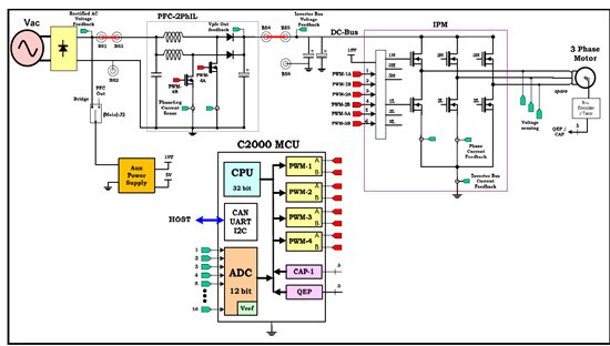

    You can try using the HVMTRPFC Kit for this purpose,  the kit has a boost and an inverter stage on the board, below is the snapshot of the stages on the board,
    The stages on the board are connected together through banana cables, so all you would need is to connect a battery to the PFC Boost stage,
    A software for Boost and motor inverter is available, through controlSUITE with PFC boost on CLA,
    From some practical experiences, the kit has nothing about regenerative braking on it, so if you break the motor you can see the Vdc Bus rise as the spare energy is regenerated. You would need another stage at the BS4-5 (an external board), which should be able to tap into this energy,
    The challenge would be communicating between the the stages on this board and the external stage you would need to connect to this, there is CAN and SCI options available,
    if you design your own board all three stages can be controlled using one single controller,
    Also this board is not designed with most optimal power electronics which you would need to spend time on   ,
    -Manish Bhardwaj
