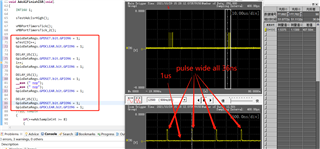

I got a a question about GPIO output of 28377S  :
In the datasheet , I saw GPIO CLK is equal to SYSCLK, so I test the GPIO max frequency like this:
C code
GpioDataRegs.GPDSET.bit.GPIO96 = 1;
GpioDataRegs.GPDCLEAR.bit.GPIO96 = 1;
and
__asm (" nop");
__asm (" nop");
Pulse wide is the same, 36ns!
If it is equal to SYSCLK, then the maximum frequency of GPIO should theoretically be 200MHz, then the pulse time in the waveform should be 5ns, but it is 36ns after the test. Why?
  • This is probably due to the way that the Ccode that you have written is being translated to assembly.
    I have tested it with back to back writes to the registers, which take a couple assembly instructions resulting in ~25nS wide pulses. Then adding two NOP instructions I see that pulse width grow to ~35nS. This was tested on F28388D, but there should be not functional differences.
