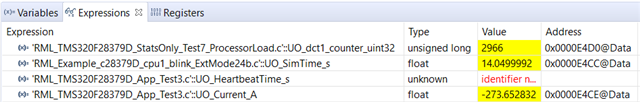

  • Thank you Ram, those tips really helped with my model now. I wanted to check and clarify things further.
    so the timer output is in microseconds if I have understood it correctly.
    my value is 2966 and the task is running at 0.01 s (that's what the Model Config Solver is set to)
    So can I divide 2966 us / 10000 us ? That would equal 0.2966.
    Is there any other further calculation required to get an estimate of processor load for this board? Does this value equate to 30% or 3% for example?
    Excuse my lack of knowledge in this area and if I ask trivial questions. It has been 6+ years since I last did these checks on a previous control unit. Thank you.
  • Hi Chris,
    The difference value of 2966 is the CPU timer count. To convert this to CPU time, need to multiply it with the CPU CLK time per tick.
    i.e, 2966 * (1/200)us = 15us apprx. (Considering 200MHz of CPU CLK)
    This is the time taken to execute the functionality of interest.
    Note that if interrupts are enabled, this time can vary depending on the execution time of the ISR.
    You can compute the % of CPU utilization as below:
    Considering the step time as 0.01sec, (15us/0.01s)*100 = 0.15%
    You may also cross check this by toggling a GPIO pin at the beginning and the at end of the subsystem or the functionality of your interest and verify it using Oscilloscope.
    Ram Alla.
