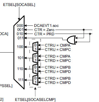

  • but my control loop, which is performed by the DCL library, is triggered I believe by my PWM signal - so I don't see how I can trigger the ADC samples any earlier
    An alternate approach would be to trigger the ADC SOCs using an arbitrary early EPWM CMPx value and service the control functions in the ADC EOC ISR.
  • Hi Tommy,
    I am trying to implement this approach but I can't see how to it is any different than my current implementation, where the ADC is triggered at TBCTR = ZRO and the controller is serviced by the EOC ISR. What is the benefit of slightly delaying the start of conversion rather than just using ZRO?
    I was thinking to generate a new CMPC that is used to start the conversions, as you explain, however it seems in this register the only option is to use CMPA OR CMPC and no options to just use CMPC. If we use CMPA or CMPC and the controller starts a conversion on CMPA match, won't the time at which an EOC is generated depend on the duty cycle of the PWM modules that are set by the CMPA/CMPB values anyway? I'd suppose you would rather to launch the ADC's at a set point in the period that does not change?
    Joel
  • I am trying to implement this approach but I can't see how to it is any different than my current implementation, where the ADC is triggered at TBCTR = ZRO and the controller is serviced by the EOC ISR. What is the benefit of slightly delaying the start of conversion rather than just using ZRO?
    Your prior description made it sound like you were using the EPWM to trigger the control ISR and waiting for the ADC conversions to take place in the ISR. Starting the ADC conversions early and triggering the control ISR using ADC EOC would push the waiting for ADC conversions to the background without stalling ISR execution.
    You have all of these to choose from:
    I don't follow. The EOC trigger in EPWM time reference would be SOCA + ADC conversion time.
