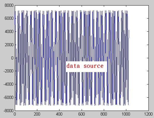

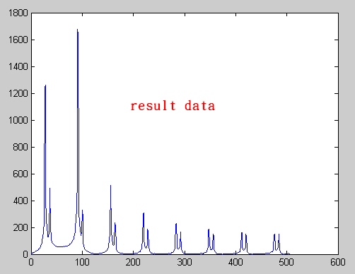

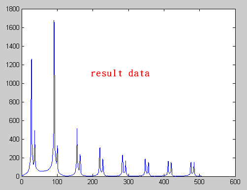

    I'm sorry about that uploaded a cumbersome project bothering you for a while.
    Now I upload another similar one and try to solve your troubles:
    There are three folders in the package, which also encrypted with a password "kenwoo".
    Compare the folders "_usage1" & "_usage2" inside, would answer your questions about fft library & IQmath.
    And the folder "_simplify" probably answers your remaining questions.
    I guess your trouble may from this: "C28x doesn't initiate global variable when using flash".
    Besides, because the fft-lib I applied is old; there might be newer fft-lib versions, if any, that I suggest to use since that might be easier to use than the old one.
    Ken.
    2703.sol_01.rar
    I show 2 pics from the "_simplify project" data.
