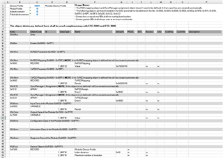

I am struggling to create a slave project from scratch with the F28388D.
All the EtherCAT examples are working. Now I would like to send one 16 bit variable called "Value" and receive one 16 bit variable "Result". The documentation ET9300 is far from straightforward for me.
  • I start SSC and create a New Project. Select the TI F2838x CPU 1 Sample (Includes Sample Application)
Got the message:
"Patch file cannot applied because configuration version (5.12) not match current SSC version "
I continued...
  • I set the VENDOR_ID, VENDOR NAME VENDOR IMAGE and DEVICE_NAME:
  • Create a new application description file (Tool-> Application->Create new)
    An Excel sheet open.
    I filled it as below:
  • I close the excel
  • Create the slave files (Project -> “Create new Slave Files”)
  • Change the source folder for the cpu1_echoback_solution ( this is the one where I want to start with)
  • Open CCS, Project->Import CSS Project ->f2838x_cpu1_echoback_solution
  • Check ecat_def.h, the VENDOR ID is the same as the SSC Slave setting.
  • Remove the old CPU1_echoback_solution.,.h and Object.h and just keep my "new app"
  • Compile, everyhting is good.

    I received the error:
    I don't understand what is wrong, Result0x6000 should be generate by SSC using my excel sheet.
    Thank you

  • Hey Hal,
    It seems the variable is not initialised to Result0x6000 directly from the Excel sheet instead as Obj0x6000. (Seems to be an issue with the SSC Tool)
    An easy fix would be the following:
    Go to "F2838x CPU1 New AppObjects.h"
    Locate the Object Variable Definition and make the change
    //*********For variable Result************
    * \brief Object variable
    PROTO TOBJ6000 Obj0x6000
    //      Change to
    PROTO TOBJ6000 Result0x6000
    Similarly for the variable Object
    //*********For variable Value************
    PROTO TOBJ7000 Obj0x7000
    //      Change to
    PROTO TOBJ7000 Value0x7000
    Hope this helps.
    Sahil.
