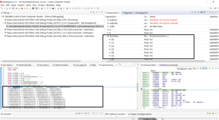

hi ,
I am defining an array in CLA  file. However, when I debug through ccs, the variable reads 0 in the watch window.
 float x[] = {1,2};
The x size is correct in CCS watch window but the values are 0.
Can we not use arrays inside CLA?
Mukul

  • Hi Mukul,
    in CLA it is not possible to initialize a variable when declaring it (there is no memory section for initialized variables).
    The initialization must be done in a task that is called during system initialization, preferably in task 8 as it has the lowest priority.

  • Hi Veena,
    I am talking about local variables. I tried using the array in one of the examples from TI. When I boot  from RAM, the initialization works during declaration. However , it does not work when I boot from flash.
    Mukul

    I am using TI example cla_ex1_asin. I didn't make any change in the command linker file . I had just added a dummy code in the cla task.
    here are the reproduction steps:
    1) Working Configuration:
    Set in build configuration  CPU1_RAM as active and deploy code in hardware. I could see the array values in the ccs watch window.
    2) Not working Configuration
    Set in build configuration  CPU1_Flash as active and deploy code in hardware. I could not see the array values in the ccs watch window.
    Let me know if you need any more information to reproduce the issue, or is there something that I am dong wrong.
    Mukul
  • Hi Mukul,
    I think I found the issue. In case of Flash configuration, we are loading CLA const section in Flash and later copied to RAM. This copying is missing in the example.
    The following copies the CLAProg section. Similarly, you need to do the same for const_cla section as well.
    memcpy((uint32_t *)&Cla1funcsRunStart, (uint32_t *)&Cla1funcsLoadStart,
    (uint32_t)&Cla1funcsLoadSize);
    Veena
