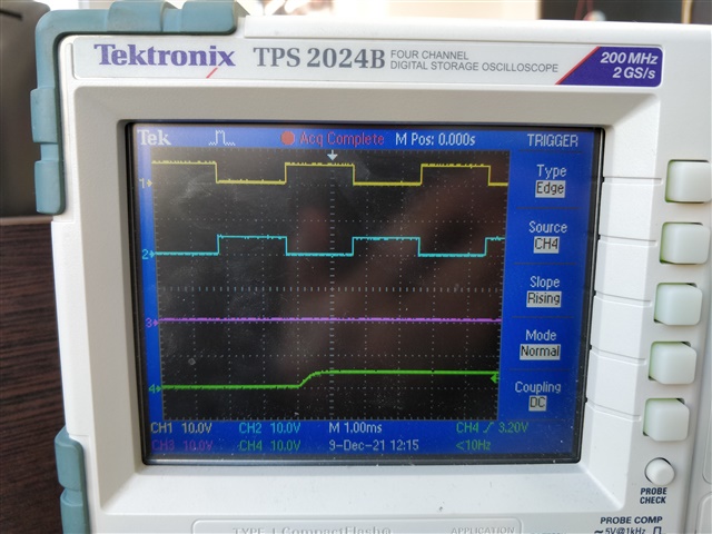

    Here are some waveforms, that we got.
    1. Here we have our PWM output signals on A and B channels with ~250 Hz frequency.
    2. Now we try to force DCA event every 1 ms. Note that the time axis is 250 us/div, instead of 1 ms/div - we enlarged one PWM pulse to take a close look. We can see, that the yellow signal is blocked just for a moment (next to the first yellow cursor) and the it's unblocked again. And the same picture 1 ms after that (because we force the event every 1 ms).
    3. If we look even closer, we can see the duration of "blocked" signal - it's about 125 ns.
    The signal is falling slow, because we measure it not on the CPU output, but on the output of some pull-up/pull-down circuit on our control board:
    As we expect, the signal must remain blocked until we clear the event flag. But it doesn't work that way.

    Could you toggle some GPIOs at each case scenario (drive GPIO high when event is forced, drive GPIO low whenever event is cleared)? This is just for debug to ensure that the flags are being set for the desired duration.
    Sure.
    On the waveforms below we show folowwing signals:
    • Channel 1 (yellow) is PWM A output
    • Channel 2 (blue) is PWM B output
    • Channel 3 (magenta) is GPIO (GPIO41) that is set when DCAEVT1 is forced
    • Channel 4 (green) is GPIO (GPIO40) that is set when DCBEVT1 is forced
    Here is our code to toggle gpio:
    if (cpu01.debug.debugI1 == 1)
            EALLOW;
            EPwm7Regs.TZFRC.bit.DCAEVT1 = 1;
            EDIS;
            GpioDataRegs.GPBCLEAR.bit.GPIO41 = 1;
        else
            EALLOW;
            EPwm7Regs.TZCLR.bit.DCAEVT1 = 1;
            EDIS;
            GpioDataRegs.GPBSET.bit.GPIO41 = 1;
    if (cpu01.debug.debugI2 == 1)
            EALLOW;
            EPwm7Regs.TZFRC.bit.DCBEVT1 = 1;
            EDIS;
            GpioDataRegs.GPBCLEAR.bit.GPIO40 = 1;
        else
            EALLOW;
            EPwm7Regs.TZCLR.bit.DCBEVT1 = 1;
            EDIS;
            GpioDataRegs.GPBSET.bit.GPIO40 = 1;
    IMPORTANT NOTE 1: on our control board GPIO40 and GPIO41 go to inverters, so we use "GPIOCLEAR" to generate HIGH signal on the waveforms, and "GPIOSET" to generate LOW signal.
    IMPORTANT NOTE 2: the mentioned inverters are open-drain schemes, so the rising fronts of the 3 and 4 channels on the waveforms are sloped.
    Here are the waveforms:
    1. Here we have PWM outputs A (yellow) and B (blue) switching with ~250 Hz frequency. Then we set "debug1 = 1" to generate "DCAEVT1". You can see that GPIO41 (magenta) goes high at these moment and stays like that. But PWM channel A (yellow) continues switching:
    2. Then we set "debug1 = 0" to clear "DCAEVT1" event. GPIO41 (magenta) goes low as expected. PWMA (yellow) keeps switching.
    3. Now we set "debug2 = 1" to generate "DCBEVT1". You can see that GPIO40 (green) goes high at these moment and stays like that. But PWM channel B (blue) continues switching:
    4. Finally, we set "debug2 = 0" to clear "DCBEVT1" event. GPIO40 (green) goes low as expected. PWMB (blue) keeps switching.
    As you can see in the code, when GPIO40 and GPIO41 are high on the waveforms, DCA and DCB events are forced every 1 ms and never cleared.
    But on the waveforms we still see them switching.
    If you wish, you can reproduce the problem even in the infinite while(1)/for(;;) loop using the code from my previous message.
    The idea is not to force DAC/DCB events every few CPU cycles (which are 200 MHz freq), but only once, when a variable is changed.

  • Hi Disona,
    Thank you for detailed debug. I will have access to hardware tomorrow and will provide an update then once I duplicate the issue you are seeing.
    Marlyn
  • Hi Disona,
    I was able to duplicate what you are seeing. I'll work on finding a route cause now that I can duplicate the issue.
    I will provide another update for you on Monday.
    Marlyn
  • Hi Marlyn
    That's great! We will wait for the results.
  • Hi Disona,
    Thank you for your patience. Today I altered my code to operate in a similar fashion as yours.
    EPWM1 (Channel 1) is ~250Hz and EPWM2 (Channel 2) is ~1000Hz.
    The Interrupt for EPWM2 is generating the force and clear trip zone flags for EPWM1
    Even when 'debug1' is set as one and the DCAEVT1 flag is set, the output remains as in the screenshot above (duplicating the results you see).
    After looking at various options for why this is happening I believe I need to loop in our design team. I will provide an update by Wednesday with their response. I just wanted to touch bases with you and let you know this is something I am working on.
    Marlyn
  • Hi Marlyn
    Thank you for keeping us up to date!
  • Hi Disona,
    I don't have an update yet but will let you know as soon as I hear back from our design team.
    Bet Regards,
    Marlyn
  • Hi Disona
    I wanted to provide you with a possible work-around while we wait for the response from the design team. Please take a look at the code below, specifically the msISR() which is the ISR that is forcing/clearing the trip zone event. I force a one-shot event and clear it but change the TZA/TZB actions according to "debug1" and "debug2" to control the state of ePWM1A and ePWM1B independently.
    I will be out next week for the holidays but have asked a team member to monitor this thread in case you have questions or we hear back from design.

    Marlyn
  • Hi Marlyn
    Thank you for this work-around.
    For now we just de-mux PWM GPIOs into "Input" mode, when we want to turn off PWM.
    This works ok, but we still would like to get the answer for our DCA/DCB question.
  • DCA/BEVT force will only be a short pulse when using SW FRC. Then the DCxEVT condition will no longer be on. Therefor the ePWM will resume. If using the RAW DCxEVT action, you will only see your ePWM disable for the short amount of time that the SW FRC pulse is propagating through. There is no continuous SW FRC for DCxEVT. What you are seeing is expected. You would have to use the OST latch to keep the SW FRC active.
    Nima
  • Thank you for the answer.
    Ok then, if this works as intended, we have no other option than to de-mux GPIO.
    Re-initing TZA/TZB is not our case, because we need to have ability to turn off the switches when want AND block them in HW when fault signals comes from the switch.
    Therefore we cannot use the method, that Marlyn had suggested.
    But we are puzzled with such behaviour.
    Could you please provide any usecase where one can need such a short blocking pulse?
    Because we expected, that the TZ condition will stay as long, as FLG remains set.
    And the documentation on this subject is not clear, as we think.
  • The FRC for DCxEVT is meant to be used along with CBC anc OST and not the RAW DCxEVT. That is why there arent any useful cases, other than introducing some GLITCHES and making sure that the DCFILT signal can filter them out.
    Nima
  • Ah, ok!
    Thank you!
