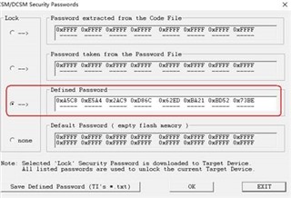

The c# example program in the installation directory does not have CSM defined password function code.
See C2000-gang manual  is not very clear. Can you provide specific examples and procedures?
It is best to provide code application examples, Thank you.

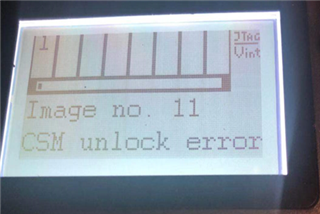

                                                                                                                       error info
