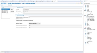

I have created an environment with a project in Flash as follows. You can jump from one project to another as needed.
1-(non BIOS)
2-(non BIOS)
3-(sys/BIOS) 6.75.2.0C
*** When you jump to 1=>3=>2, CANB communication cannot be received. ***
I'm assuming I'm missing a BIOS release step when exiting 3.
Can you tell me what I am missing?

The following is what is set in app.cfg.
The contents of CAN set at the time of the start of 3 are as follows.
