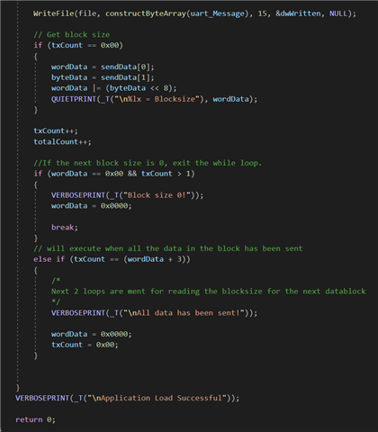

After that I started changing the serial_flash_programmer to a can_flash_programmer. I did this by constructing a UART message in the way our STM controller understands that it is a CAN message which needs to be sent to the driveline board. Our message consists of a 4 byte header a 2 byte ID followed by 8 bytes of data finished with a checksum. The header and ID are constant variables and the checksum is calculated in the code itself. Since the CAN module on the F28069M reads 2 bytes at a time I have changed it as followed:|
TI's example serial_flash_programmer:
my own can_flash_programmer:
This makes it read 2 bytes each time that will be used to construct the message by doing the following:
This refers to the following function that constructs our message:
Then we want to write the message to the STM controller I do this by first constructing a bytearray in the following way:
And after that I run this writeFIle command:
since CAN does not use a checksum and reads 2 bytes at a time instead of 1 I have also changed the rest of the flash_programmer to the following, the code shown is the code starting form calling the writeFile from above:

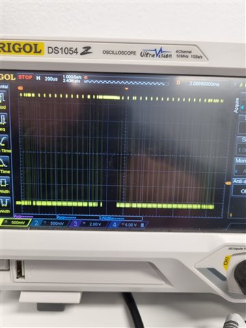

  • Hi Anu, this is the result I get from the oscilloscope:
    The weird thing is that the 2 first signals are digital but the other signals is more in a sinus wave which isn't correct if im right. So I was wondering what could be the problem?

  • Guilliam,
                    I think communication between the STM board and the Driveline board (which contains two 28069 devices) is done through CAN. i.e. there are at least 3 nodes on the CAN bus (two 28069 and one STM controller). Is my understanding correct?
    I presume the waveform you attached was measured at the CANRX pin of (one of the) 28069 device. Forget CAN,  this doesn't even look like a digital signal. Would you be able to provide the circuit for the CAN connection between the STM controller and Driveline board? You could share it privately with me by initiating a friendship request.
    Have you looked at the debug tips in www.ti.com/lit/spra876?
  • Hi Hareesh,
    To answer the first question about the nodes you are correct. In the real situation we have a STM controller that sends the CAN messages to the driveline board. This STM controller and board are connected with a CANbus indeed.
    The waveform I attached is the signal sent to the Dev board. I connected the scope to the jumper cable that connects the MCP2551 to GPIO30(CANRX) of the devboard. Today though we found out there was a problem in the connection between the parts. We fixed this and got a much more approachable output:
     This is the signal we get on the Dev board.
    We also read the RX on our driveline board. This gave the following output:
     This is the signal we get on the driveline board.
    As you see it is quite the same but not exactly. So I am wondering what could cause this. I am now trying to get my hands on an oscilloscope with a CAN trigger/decoder for better understanding but cannot guarantee being able to get one.

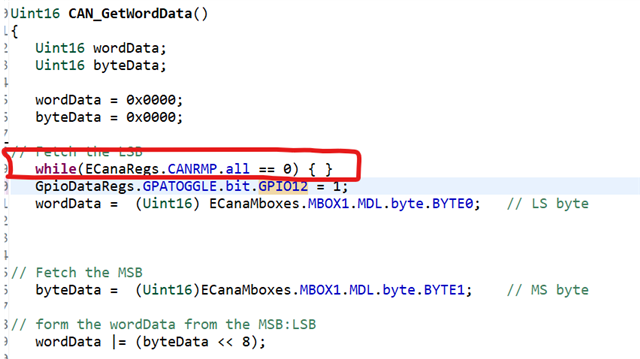

  • I went further with some debugging after finding out about the TX pin. I did this by checken where in the can flash kernel the program gets stuck by toggling one of the leds on the board. And I found out it got stuck in the getworddata at the loop where it checks the RMP:
    At line 300 I toggle the bit. When I put this line before the while loop at line 299 the led goes on. When I place the line in the brackets at the while loop the led goes on. But when it is placed after the while loop the led never goes on. Therefore I assume that there are no incoming messages.
  • Guilliam,
                    The waveform looks more like CAN now. I agree that you would benefit from a scope that can natively decode CAN waveforms. The waveform on the TX pin and the RX pin will seldom be exactly identical. (1) This is because of the ACK bit which is driven dominant by any receiver. Refer to Figure 2-6. Waveform at the CANRXA Pin in www.ti.com/lit/sprace5. (2) The difference in waveforms can also be observed during the arbitration phase, if there is more than one node competing for the bus. Note that any/every node on the bus will acknowledge a frame. I have explained this clearly in my Application reports. A good reference for waveforms is www.ti.com/lit/spracq3
    On a different note, I am bit lost as to exactly what help you need from me. I am happy to help you with any CAN hardware related query, but may not be able to help with issue related to your custom bootloader.
  • Understand C3 and C6 are capacitors. My question was why are they needed on the CANRX pin. The capacitors have the effect of increasing the rise/fall time of the CAN signal at the CANRX pin. May not be the reason for the issues you are facing, but wanted to bring it to your attention anyway.

    I have also tried to debug where the program gets stuck on the developmentboard by doing the same LED indication I tried on our own board, as stated in my question from 7 days ago. I changed the GPIO to 34 because that is the correct one for the devBoard but strangely enough this doesnt work then. I don't know why but even if I toggle the led before the loop it doesnt turn on. Do you maybe know what is the diffrence in this might be? The only diffrence I can find between our own board and the devBoard is that the devBoard has a tms320f28069MPZT and the devBoard a tms320f28069UPZT. I tried to find the diffrence between these but I couldn't find anything that might cause this problem. I might be wrong but would be more than happy to hear this from you.

  • Guilliam,
    Is it possible to load the CAN kernel via JTAG in CCS and pause execution once the transmit has occurred? If the kernel is not receiving anything we need to first find out where the program is stuck.
    Anu
  • Hi Anu,
    The kernel is sadly enough not receiving anything. I have already loaded the kernel on both boards using the JTAG debug probe. To see where the programm gets stuck I coded a line to turn on the led once it receives anything but that does not work. It stops at this while loop in the GetWordData in the CAN_Boot from the can_flash_kernel.
    When I put the line that comes after that (the line that turns on the led) in front of the loop the led goes on. But when I put it after the led and I send a CAN message nothing happens. And I have verified with the oscilloscope that the RX pin receives a signal. So what I might think is something goes wrong in the pheriperal settings for the eCAN module but I don't see anything strange in there. What do you think might be the problem?
