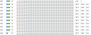

  • I have additional questions.
    1. How to use continuous receive interrupt using RX BUF?
    MCAN_INTR_SRC_DEDICATED_RX_BUFF_MSG,
    MCAN_readMsgRam(MCAN0_BASE, MCAN_MEM_TYPE_BUF, 0U, MCAN_RX_FIFO_NUM_1, &drv_mcan_rx_msg);
    2. When using RX FIFO, there is a continuous receive interrupt, but why is it branched to interrupt twice?

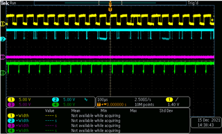

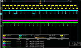

  • Thanks,
    This is my final mcan source.
    it's working...but i don't know why occure irq twowice...

    As above, I also wanted to make CAN-FD.
  • i want to solve why interrupt takes 2 times,
    In my system, the main interrupt is a timer and operates at 20khz.
    For UI interfacing, for communication data load test, send data at a frequent cycle rate, and try to match the number of received irqs.
    Reception of both CAN and CAN-FD is normal. No data is lost.
    However, the main timer interrupt is broken in CAN-FD.
    CAN does not break the main timer interrupt.
    For CAN-FD
    For general CAN
    Both are operated in CPU1, and yellow is the signal for checking the operation of Timer 1.
