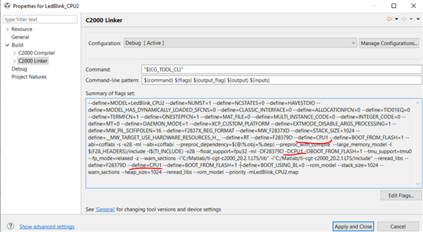

I selected the CPU2 in Debug -> Flash settings.
I am not sure, if these flags for the C2000 compiler and the c2000 linker are correct. Because there is CPU1 mentioned.

  • You're right.
    It seems that it was a bug in MATLAB Embedded Coder.
    Despite the core selection CPU2 in the hardware settings, the code generation does not seem to take care of this. (As the flags in the screenshot above shows)
    I copied my complete Simulink model in the c28379D blink example and now it works.
