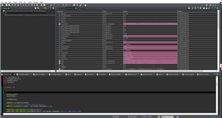

    Can I see the entire CCS IDE when the issue happens (especially the Debug view)?

    These are the files you requested.
    In the first image you can see the single time graphs were blacked out after second debug session.

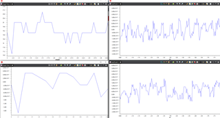

  • This is the first time

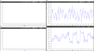

    This is the 2nd time
    This is the 3rd time
    Evey time after this is like the 3rd time.
    It only resets if i closed all the graphs and relaunch it from scratch.
