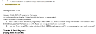

Use the
LONG WINAPI C2000GANG_ImageFileLoad( LPTSTR filename, LPTSTR passw, LONG mode );
function (see C2000-GANG.h ) file. First it should be selected the image number where the file must be saved
LONG WINAPI C2000GANG_SelectImage(LONG lImage);
As the file name use the .c2000gangbin file.
Let me know if you have any questions.
Gregory Czajkowski
Elprotronic Inc.
Hi Gregory Czajkowski.
Thank you for your support.
I added firmware to C2000_Gang successfully. I think you should update this feature in your user manual, it's an advanced function.
