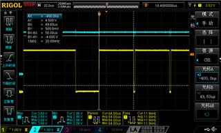

    I shorted circuit CANH and CANL.And see the figure below for the waveform:
   My question is:
1、According to this waveform, what frame format was this?
2、The first Low level time was 17 bit times; and the later low level time was 1 bit time. Does such a waveform have any special meaning?
  Thanks!

    It is likely an error frame.
    But, I noticed that it is neither "active error frame" nor "passive error frame".
  • The 17-bit low-time could be an active error frame.

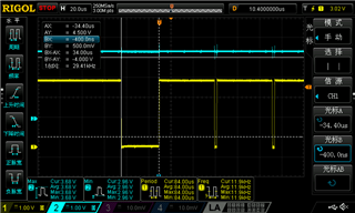

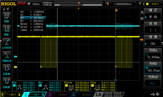

  • What is the CAN module doing while the CANH and CANL pins are shorted? Is it idle or is it trying to transmit? Can you attach the oscilloscope waveform of CANTX & CANRX pin when this experiment is being done? Exactly what is the objective of this experiment?
  • The CAN module was sending data frame while the CANH and CANL pins are shorted. And I  attach the oscilloscope waveform of CANTX & CANRX pin in the experiment. The yellow waveform is CANTX.
    In addition, the purpose of my customer is:  whether the bus can be restored in the event of a CAN failure.
       Thanks!
  • If the objective is to determine "whether the bus can be restored in the event of a CAN failure", I don't believe this is a valid experiment. Most of the CAN transceivers offer some level of short-circuit protection. This includes shorting of CANH or CANL with supply or GND. This also includes shorting CAN_H & CAN_L together. Once this error condition is removed, the module should recover on its own after the elapsing of 128x11 recessive bit-times.
    In any case, I tried this experiment on my setup and did not see the waveform you had attached in the post. I only see CANTX pin staying at 3.3v when I shorted the CANH & CANL pins.

  • I tried it on a F38335 device connected to a SN65HVD232 transceiver.
  • Thanks very much! By the way, is the CAN module sending data frame while  CANH and CANL are short-circuited? My customer  did that so.
  • Yes, the CAN module was transmitting data at a very high bus-load.
