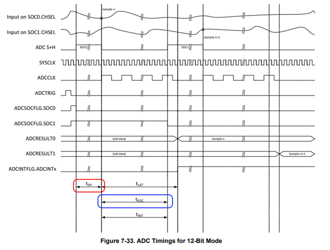

I have 6 analog signals.
3 connected to ADCA and 3 connected to ADCB
I need to sample all 6 signals at the same time, or as close to each other as possible.
I have configured as fallows:
SOC0 -> ADCA ch2, trig EPWM1
SOC1 -> ADCA ch3, trig EPWM1
SOC2 -> ADCA ch4, trig EPWM1
SOC0 -> ADCB ch2, trig EPWM1
SOC1 -> ADCB ch3, trig EPWM1
SOC2 -> ADCB ch4, trig EPWM1
ADCA interrupt.
acquisition time is set to 60 clocks. 60 * 5ns = 300ns.
I have 2 questions:
1: what is happening in this current configuration?
I was guessing that on EPWM1 trigger, a conversion will start on all channels?
Are all 6 channels sampled every EPWM event?
Do I need to use Burst mode to make this work properly?
2: when profiling on the scope, the time between EPWM1 trigger and ADC ISR is 1.5us
that is 5 * 300ns conversion time.
I don't understand this result.
I would expect, (if ADC A and B are sampling simultaneously) that the conversion time will be 3 samples * 300ns.
I would love some guidance on the best configuration.
