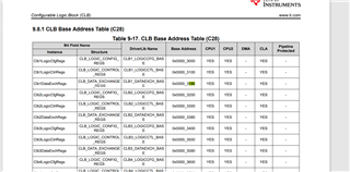

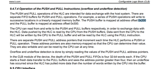

I was trying to push some data to CLB exchange memory. What I read from the reference manual is that offset adr for exchange memory is 0x200(first pic) but when I debug I got the data at 0x180. Then I check the manual again and saw that ofset adr is 0x180(second pic) for the exchange regs. That matches with my debug also. My question is that am I doing somethings wrong or is it a mistake in the refernce manual?
