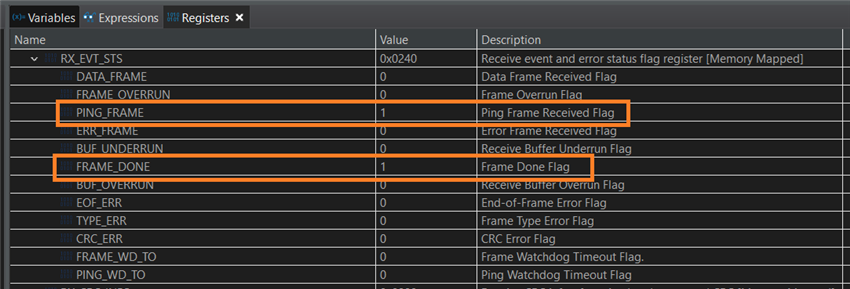

  • Hi Masahiro,
    I performed a test on F28004x (same FSI type as F2838x) and confirmed that both FRAME_DONE and PING_FRAME flags do get set when receiving an FSI Ping Frame. See below:
    Kevin
  • Hi Kevin,
    Thank you for your cooperation in the survey.
    As a result, I was confusing PING_TAG and FRAME_TAG, so I was able to receive correctly(At this time, FRAME_DONE was cleared, so the flag ON was not recognized.), but the frame was discarded due to a TAG mismatch.
