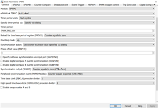

  • I used code generation of Simulink and I have set the phase shift of ePWM1 to 1 instead of zero. Here is the code:
    EPwm1Regs.TBPHS.all = (EPwm1Regs.TBPHS.all & ~0xFFFF0000) | 0x10000;
  • Then you still have the PHSEN set to "enabled" mode. That could be what is causing this. Do you have the generated code?

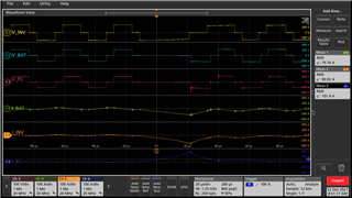

  • I deactivated the phase shift for ePWM1 (the main one) and it ran well with a set of our high voltage DC supplies. When I changed the supplies it started having issues again. Do you think the noise on 3.3 supply or the ground can cause an issue like this?
    I have actually measured 3.3 V to ground and here is what I got:
  • I dont think the noise is the issue based on your capture. Is this a custom board?
    Nima
  • Yes it is a custom board.

  • Okay in that case, what is the maximum phase shift value that causes the issue?
  • Marzieh,
    Did you figure out the threshold of the PHS value that caused this?
    Nima
  • Thanks for following up. After you asked about the phase shift value, I checked our simulation and noticed that the phase shift goes from -val to +val. The way we have programmed negative phase shifts is to enter them as (cycle-phase shifts) so I thought maybe it is going from 5800 to 200 in a 6000 cycle and that is what is causing the issue. Then I added another line that will assign zero to the phase shift if it is within -val and +val. I have only tested this in certain conditions and it has worked so far. If it works at all conditions, I will close the case. Thank you very much for your help.
  • Thank you please click the verified answer (green button) on all of the thread responses that are relevant to helping you find the solution.
