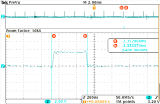

Thanks in advance. I would like to set a PWM interruption at 10KHz. I set it in up and down mode, CLKDIV= 2, HSPCLKDIV = 0. Thus, the frequency should be 200Mhz/4 =50MHz. And TBPRD is set to 2500. The ISR frequency should be 1/[2*2500*(1/50e+6)]=10KHz.
However, when I use the GPIO toggle to check it, it seems the clock signal for ePWM module exist a problem. The figure below shows the output of the pin which set GPIO toggle to 1.
Could someone give me a hint on that?

    The output observed on the scope doesn't seem to the PWM output. Because PWM output should switch from 0 to 3.3v.
    The signal shown seems to have very small amplitude. Is there some noise source being coupled on to this pin?
    Do you have any other signals connected to this pin on the board?
    Can you try and check some other PWM output?
    Many thanks for your feedback. I tried to use another pin to do the test. However, the same results. I  doubt is there any problem with my testing code.

    I suggest you pick the example code and run it as it is on the hardware before trying your own configuration.
    Try a basic PWM example and observe the behavior at the pin.
    You can even try tp disable the PWM module and check the behavior on the pin to see if there are some other drivers on the pin causing this behavior.
    What you are observing is clearly not PWM output. There is some noise or some other loads connected to the same pin.
    I would also suggest to check the measurement setup like the probe etc.
    Many thanks for your feedback. Now I get the true situation. My ISR frequency is about 920Hz, which is different from my settings. I will go to check it.
