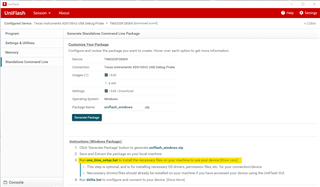

in the file one_time_setup.bat seems the important part of the code to be missing.
@echo off SETLOCAL SETLOCAL ENABLEDELAYEDEXPANSION
Uniflash version 7.0
Windows
Device: LAUNCHXL-F28069M (LaunchPad)
I just generated a package using UniFlash 7.0. Those lines are still in the one_time_setup.bat file that was generated. Can you share your generate bat file (the entire file)?

The generated one_time_setup.bat is available under the following link: https://workupload.com/file/M6Ja8C9JqeH
The file does include the three lines in the posting above.
1) Disable the echo function.
2) Create a local container for parameters.
3) Set the local parameter ENABLEDELAYEDEXPANSION.
But where are the lines which are doing the following job mention in uniflash:
Run one_time_setup.bat to install the necessary files on your machine to use your device [Show Less]
The commands that appear in that bat file will vary depending on the device and debug probe used. For example, there will be extra setup needed for XDS110. If there are no additional commands needed, then you will not see anything beyond those three default commands that are always there.
Ah, sorry I understand now. You are simply using the exported package with a clean Windows 10 installation.
I suspect I know what is happening. I may need to follow up with engineering tomorrow morning. I will update you as soon as I can.
ki
I took a closer look and not only is the one_time_setup.bat incomplete... but it looks like the exported package is missing the drivers for the XDS100 completely.
Can you try the below workaround:
1) download and extract the contents of the below zip into: <UNIFLASH EXPORTED PACKAGE>\ccs_base\emulation
If extracted correctly, you should have a path to the ftdi drivers such as:
2) replace one_time_seup.bat with the one below:
ki
I filed a bug for this. Tracking link: https://sir.ext.ti.com/jira/browse/EXT_EP-10728
I don't have a timeframe yet but will push to get it into the next release if possible.
