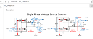

    Thanks. And here's some additional questions about hardware(please let me know if these questions are needed to be posted on a new thread):
    1. The customer is using #if SENSING_OPTION == ADC_BASED_SENSING, that is, ADC_BASED_SENSING mode, which is the circuit on the left side of the diagram below:
    Voltage loop control is easy to understand, but how does the current inner loop implement the control duty cycle invDutyPU? Is it a DCL implementation? Are there any related articles or instructions for using DCL?
    2. The H-bridge outputs a SPWM wave in equal amplitude, what does the H-bridge current waveform look like? What does the waveform on the inductor look like? How is the voltage across the inductor calculated?
    Thanks and regards,
    Cherry
  • Hi Cherry,
    Check the User's guide shown below. It has current loop information TIDUB21D. Also, you can check DCL from the link below.
    https://www.ti.com/tool/C2000-DIGITAL-CONTROL-LIBRARY
    You have an inner current loop and therefore, the inductor current also follows sinusoidal reference. I don't think it inductor voltage is not being used in the control loop.
    John
