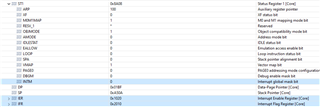

  • It looks like IFR is getting set but the IER bit to enable INT5 in the CPU isn't set.  If you enable it in IER do you start seeing interrupts? Can you look through your code and see if you are accidentally clearing that bit in IER at some point?
    Whitney

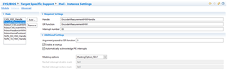

  • This is my code for the HWI. How do I enable the IER? What code would clear the IER?
    //  ======== EncoderMeasurementHWI ========
    Void EncoderMeasurementHWI()

  • Your Hwi function looks fine. Do you write to IER directly in your code anywhere? Do you call any interrupt related functions in your code? If you single step through your code and watch the IER register in the watch window, do you see any functions affecting it?
    Whitney
  • This is the only location where I write to IER directly. This was used for another interrupt.
    // Enable interrupts required for this example
       PieCtrlRegs.PIECTRL.bit.ENPIE = 1;   // Enable the PIE block
       PieCtrlRegs.PIEIER6.bit.INTx1=1;     // Enable PIE Group 6, INT 1
       PieCtrlRegs.PIEIER6.bit.INTx2=1;     // Enable PIE Group 6, INT 2
       IER=0x20;                            // Enable CPU INT6
       EINT;                                // Enable Global Interrupts
  • This code may be your issue. You write IER = 0x20, which enables INT6 but disables all other groups. Does it make a difference if you write IER |= 0x20?
    Do you have a Hwi for this other interrupt? Is there a particular reason why you aren't letting SYS/BIOS handle the PIE and CPU configurations for the interrupt?
    Whitney
