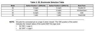

- We want to check it with Flash Boot, so we set the DIP Switch as follows.
s1:a_1 = OFF / s1:a_2 = ON
s2:1 = OFF / s2:2 = ON

    After that, when I press the reset switch on S1, D1 and D2 do not light up and it does not seem to flash boot automatically.
    Please let me know if I'm wrong, but is it correct that this debug board "loads and boots from flash when power is on" in the flash boot setting?

    I tried the C28x_dual example on my control card and I can see the LED blinking even after a power-on reset.
    I believe the setting should be both the switches on S2 in the OFF position
    Veena
  • Thank you.
    I was able to get the flash boot to work with the specified DIPSwitch.
