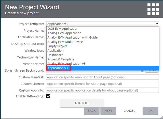

    Following your remark, I checked the "About" button in my GC dashboard, and I got the following information,
    So it seems that the version is 3.0.0 (but I am not sure).
    Anyway, if I tried to search for another version on the net, each time, I end up with this version.
    Could you explain the process for getting the right version.
    Many thanks again for your advice.
    Best regards.
  • GC will default to v2 unless you explicitly chose the v3 option when creating a New Project:
    See Chapter 3 of the GC User's Guide for more details on the v3 Component Library:
    https://dev.ti.com/gc/v2/help/GC_UserGuide_v2/index_gc3.html

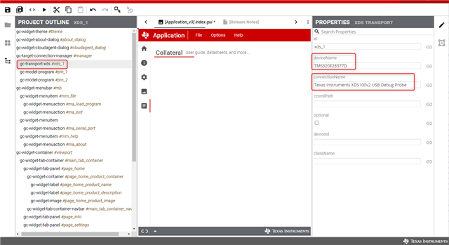

    Then from the Project Outline, I select gc-transport-xds and specified the deviceName and connectionName as below in the properties (it should autopopulate suggestions as you start typing in the fields)

    Finally I set the properties of the Connection Manager. For the activeConfiguration, I want to specify both Progam Managers. I found that xds_1+pm_1+pm_2 didn't work. But xds_1(pm_1,pm_2) did:
    This seemed to work. When I run the app, I can see GC connecting and loading to both cores.
