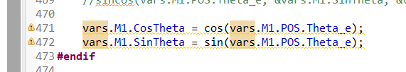

I have started a new project with the F28069.
As far as I know, I am using the Fast RTS library.
However, sine and cosine function calls each take 463 cycles, which is excessive.
The map file shows that the sine and cosine functions are pulled from the fast library.
What could be going wrong?
Thank you,
Tomas

    I see that there are some warnings on lines 471 and 472. Can you tell me what they are?

  • I see that there are some warnings on lines 471 and 472. Can you tell me what they are?
    Hello Shanty,
    The warnings are "Description Resource Path Location Type function "cos" declared implicitly Dyno_main.c /Dyno_F28069 line 471 C/C++ Problem".
    I did fix those warnings by including by the math header file (#include <math.h>). This has not changed the performance.
