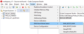

    With CCS connected, CPU boot as per EMULATION BOOT and if that is not set correctly then after reset it'll not jump to application. Please check device TRM for more detail about EMULATION BOOT.
    - where to find the reset vector for CPU1/CPU2? Are you referring to the on ein startup_css.c file with name "vectorTableFlash" ?
    When you issue reset from CCS (debugger) the PC points to reset vector. Put a breakpoint there.
    So after performing CPU1 reset if CPU1 boots and main function also executes Device_bootCM(BOOTMODE_BOOT_TO_FLASH_SECTOR0) which releases CM also correct ?
    That is correct. Please check the emulation boot setting and once you correct that, it should be able to jump to main after reset.

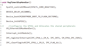

    And I'm facing another issue here,
    In CPU1 when we receive an API I will be resetting CM Core using "SysCtl_controlCMReset(SYSCTL_CORE_ACTIVE);"
    and will Start a timer in CPU1 and in expiry I'm calling below functions:
    I see that CM core is getting resetted and restarted from main() as expected but in main() of CM core when we call
    "IPC_registerInterrupt(IPC_CM_L_CPU1_R, IPC_INT0, IPC_ISR0);", It is going into FaultISR() loop.And I'm stuck with this debug since past 2 days trying to figure out what is going wrong.
    can you please help me out here.

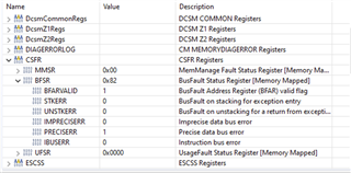

  • Pranay,
    Did you check the Fault status in CM (CFSR register - 0xE000ED28) to know what has caused the fault ?
    Vivek Singh
  • Hi VIvek,
    I'm seeing below data in CFSR register:

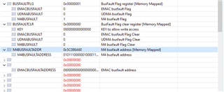

    I further tried digging the root cause and found this;
    I see that Bus fault address register :
    next tried searching that address in disassembly but didnt find anything.
    --Pranay
  • Pranay,
    Look like some issue with un-initialize pointer. Please check for that in your code.
