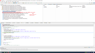

    I figured out that this error is due to redundant while loop in f2838xif_process_transmit:
    https://drive.google.com/file/d/1dEd5-ZDHZHsRrwENTAZw8TkxyldC-WXg/view?usp=sharing
    To fix it I commented lines 438-439 and 444-445 in f2838xif.c.

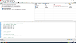

    3. When I loaded the website I got another error:
    https://drive.google.com/file/d/1xSSCqi2l5PBvr0HSx2SOJe19MdldfTW1/view?usp=sharing
    I figured out that the reason for error is mem_free() call in fs.c, line 145 so I commented it.

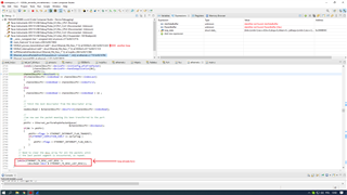

    4. When I loaded the website and clicked the button I got an error:
    https://drive.google.com/file/d/1jC-jLQLe88XCFQx-6s2NQeVlfFBjh9sI/view?usp=sharing (missing flag)
    To remove the error I added following line in fs.c after line 97:
    file->flags = FS_FILE_FLAGS_HEADER_INCLUDED | FS_FILE_FLAGS_HEADER_PERSISTENT;
    5. Now there should be no errors with DEBUG symbol.

    Yes it occurs with the DEBUG symbol. Our code is intended to work only on our hardware. I replicated the issue with enet_lwip example provided in C2000 Ware 4.0.0. I will describe it step by step.
    1. I assume that you have working example enet_lwip.
    2. I set DEBUG symbol in "Predefined Symbols" and after I load website I get an error:
      (missing flag)
