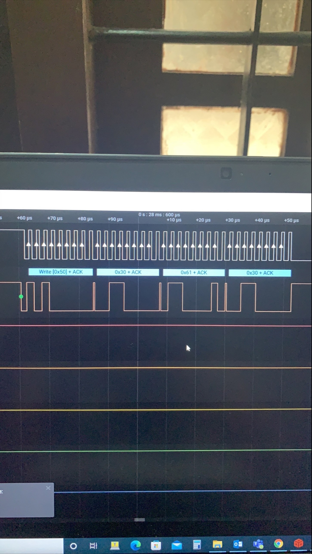

Iam using TMS320F28377SPTP_D.
Am trying to integrate external eeprom 24LC256 using I2C.
I could start the i2c communication write slave addresses, page addresses and data to eeprom. But read operation is not working.

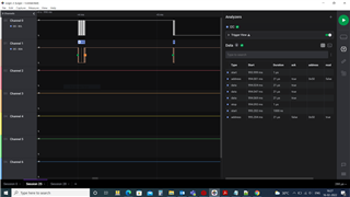

When I checked with the waveforms, I could see the write operation from start to write operation of data. But after that stop signal is missing in the waveform.
Below is my init function

    In your waveform I only see the write and command portion. For reading, I would expect a repeated start condition with slave address + read bit followed by data being read from the EEPROM. I strongly recommend trying out the other examples and SW framework.

    Even when i call the functions of write and read the waveform looks as below
    I think that my issue is, after write, stop signal is generated in software but not reflecting in the waveform.
  • Hi Sharon,
    From the 24LC256 datasheet below which operation are you trying to execute exactly? From your shared waveform it looks like a 'CURRENT ADDRESS READ'. If so, are you expecting to read back 0xFF?
    https://ww1.microchip.com/downloads/aemDocuments/documents/MPD/ProductDocuments/DataSheets/24AA256-24LC256-24FC256-256-Kbit-I2C-Serial-EEPROM-20001203X.pdf
    In your waveform the 2nd byte has a NACK at the end (F2837x device reading byte from 24LC256) which may be generated instead of a STOP condition if only reading the single byte.
    What's shown in the latest waveform is a read operation. Do you mean in the original waveform?

  • Hi Kevin
    Am trying for a random read from 24LC256. That means initially i will call write function to write the slave addresses, page addresses and data.
    Then i call read fuction which initially contains a write for slave addresses and page addresses. Followed by a read to get data. But whats happening is first write is done and second write is skipped and followed by a read with NAK.
    Is there anything to do for repeated write? Am using RM = 0.
  • Hi Sharon,
    I think what's happening is the 24LC256 is not ready to be read from yet. It may take a few read attempts before the 24LC256 responds with an ACK and the F2837x can read the data from it.
    Have you tried the 'i2c_ex4_eeprom_polling' example in C2000WARE. without making any changes yet? This example should work with no changes and handles the read commands properly. See below from example:
