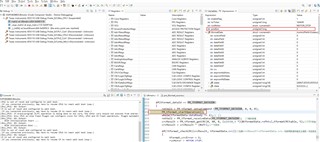

When I used the control board(Chip: F28388D) designed by myself to do the experiment about the encoder, the T-format encoder code stays at PM_tformat_startOperation,and unable to obtain rotor position information.On the one hand, I have been able to get Txen,SOMI and CLKS waveforms (The clock has a frequency of 2.5MHZ)as shown below:
On the other hand, the code stays in the PM_tformat_startOperation () function, as shown below:
Above question, hope can get expert's guidance, thanks!

    I think I found the reason why the code is stuck in the while loop. By comparing the clock waveform of F280049C (F280049C has been debugged successfully) with that of F28388D,I found that F28388D received data clock number is abnormal (the normal number of received data clock should be slightly more than the number of received data bits), as shown below are F28388D received data clock and F280049C received data clock:
    So, do you think the code stays in the while loop because of this problem?If I am right, how can I modify the code to meet this requirement?

  • Referring to the T-format guide -  When the falling edge of the response is seen, the HLC should update the match2 value for counter1.  Then FSM1 stays in state 1,1 (Receive Data) until counter1 match2 is reached.
    Did you change any of the logic related to this?
  • Hi,Lori:
    My encoder has successfully read the data, and I have changed the clock number.Thanks for your guidance!

  • Hi,Lori:
    I carefully compared the CLB parameters and modified it, perhaps because I changed the original algorithm from the beginning.In addition, SPI and CLB also have a one-to-one correspondence, which can not be ignored.
