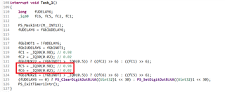

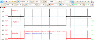

The system works when when PWM2's CMPA/B values are below TBPRD value and switched at 11 and 588.
PWM output signals are as below:

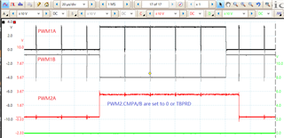

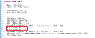

But when setting CMP2.CMPA/CMPB to switch between 0 and TBPRD (600), The program above are changed as below:
PWM2A's falling edge is changed at the center of its period. PWM2 is set to load CMPA/B shadow values
at TBCTR=0.
I don't know if this is a hardware bug, do I have any way to avoid it?
