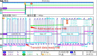

when I add test pin in the code, get below waveform.
channel 3: toggle when XRDY happen    channel4: toggle when AAS happen.
question: why AAS happen before than XRDY? if I need to exchange it, how to config the I2C module?  thanks!
  • Sorry, correct error:
    question: why AAS happen after than XRDY? if I need to exchange it, how to config the I2C module?
  • Hi Zhuo,
    I think it would help debug further if you set the IO to XRDY and AAS state rather than toggling the IO.
    XRDY will get set (HIGH) when I2CDXR is ready to accept more data, i.e. when the previous data has been copied from I2CDXR to the transmit shift register (I2CXSR). I2CDXR could be ready for more data before the slave device ACKs the address. AAS bit will be set after the device ACKs the address (as seen in your waveform).
    Also, AAS interrupt is lower priority than XRDY interrupt which may have an impact on your debug.
    Kevin
  • Hi Kevin,
    Thanks for your help!
    in my application, I must add CRC-8 at the end I2C package.
    for example:
    S SlaveAddress w CMD Sr SlaveAddress r DataLo DataHi CRC8 P
    only AAS happen before than XRDY, CRC8 will be calculated right.
    I will do an experiment, only AAS read interrupt happen, then enable XRDY interrupt. will it work?
    another question:
    I can find the spec about “AAS interrupt is lower priority than XRDY interrupt ”, could you kindly point out?
    about your suggestion("set the IO, not toggle IO"), it's a good idea, I accept.
    Thank you very much!
  • Hi Zhuo,
    I'd like to clarify your needs. The CRC8 is being calculated for the DataLo and DataHi bytes? And this CRC8 is what the F2803x slave device calculates and sends back to the master device, correct? If so, I think your experiment will work, where you'd re-enable XRDY interrupt in the AAS interrupt case.
    Good observation, it's actually still missing from the F2803x TRM. This info will be added in the next revision. The below is taken from the newer F28002x device TRM for your reference, the I2C modules are essentially the same between F2803x and F28002x.
    Kevin
  • Hi Kevin,
    Thank for your help!
    CRC8 is calculated from "SlaveAddress w" to "DataHi".
    Yes, slave device will report CRC8 to master side.
    Actually, it does work now. " only AAS read interrupt happen, then enable XRDY interrupt"
    Thanks for your photo, it's clear now.
    Kaka
