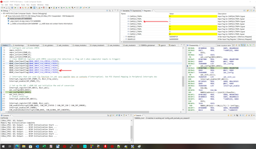

Hi expert,
I present you my problem, I have configured several comparators using the thresholds of the DAC. I want to be able to get the information of which comparator triggered, my problem is here. Can you please help me.
I also have three other signals that are connected to the tripzone via TZ1|, TZ2| and TZ3|.
I want to shut down my ePWMs when the TZ and/or CMPSS signals are triggered. The shutdown happens correctly. So I configured my CMPSS as follows (see cmpss_init and cmpss_actions functions in my code. I linked each CMPSS on a different TRIPIN signal and on an EPWM_TZ_SIGNAL_DCBEVT1 event. And by looking at the documentation on the Digital compare submodule I think I can read this trigger information in the XbarRegs.XBARFLG1.bit register.
Is this correct?
Is it normal that at initialization the bits of this register for the comparators are 1?
Should I use the function XBAR_clearInputFlag(XBAR_INPUT_FLG_CMPSSx) only to set them to 0. It seems to work at initialization in my code (I have in some cases an output that stays high at initialization I mean).
I can't explain this either?
On the other hand when I trigger the CMPSS1 for example I can't reset it afterwards in my infinite loop, why?
The bit in the register XbarRegs.XBARFLG1.bit. remains at 1. I use the function XBAR_getInputFlagStatus(x) to know which comparator was triggered.
At the init, I want to reset CMPSS outputs via XBAR_clearInputFlag, and I have a problem one or two output is at level high after the reset function (see the screenshot).
Thanks for your help
Damien

    // Configure and actions CMPSS
    cmpss_init();
    cmpss_actions(SPWM_U);
    cmpss_actions(SPWM_V);
    cmpss_actions(SPWM_W);
    // Clear XBARFLG1 register with CMPSS concerned (for detection => flag set 1 when comparator inputs is trigger)
    XBAR_clearInputFlag(XBAR_INPUT_FLG_CMPSS1_CTRIPH);
    XBAR_clearInputFlag(XBAR_INPUT_FLG_CMPSS1_CTRIPL);
    XBAR_clearInputFlag(XBAR_INPUT_FLG_CMPSS2_CTRIPH);
    XBAR_clearInputFlag(XBAR_INPUT_FLG_CMPSS2_CTRIPL);
    XBAR_clearInputFlag(XBAR_INPUT_FLG_CMPSS3_CTRIPH);
    XBAR_clearInputFlag(XBAR_INPUT_FLG_CMPSS4_CTRIPH);
    See above response.
    How are you triggering and clearing CMPSS1?
    You need to add a delay after cmpss initialization code is complete. The cmpss has a power up time. 10ms delay should be sufficient.

  • I have made progress on my problem : when I desactive in my main the first interrupt so set only the inputxbar interrupt it's work fine in TZFLG CBC.bit and INT.bit are set when input is set to 0 and reset when input is set to 1 and shutdown ePWM correctly.  Concerned the other ePWMXbar interrupt, I've made a mistake in configuration PWM_setTripZoneDigitalCompareEventCondition : EPWM_TZ_DC_OUTPUT_B1 whereas I use EPWM_TZ_SIGNAL_DCBEVT2.So I change EPWM_TZ_DC_OUTPUT_B2. Now In TZFLG register DCBEVT2 is set to 1 when enter in interrupt and reset after.
    But when EPwmXbar input is set to 0, TZFLG.bit.CBC and  TZFLG.bit.INT are always to 1 why ?

    But I have a new question related to this topic, I use CCS studio in real time to visualize registers and variables on debug mode. It run before clear TZFLGCBC register, is it a coincidence ? Because I have an error message :
    Trouble Reading Register PC:
    (Error -1142 @ 0x0)
    Device blocked debug access because it is currently executing non-debuggable code. Choose 'Rude Retry' to disable polite mode and force the operation.
    (Emulation package 9.4.0.00129)
    I tried several manipulations but nothing conclusive. The mode works if I reset only one flag on the TZFLGCBC register
    If I make this config it doesn't work, why ?
    (Error -1142 @ 0x0)
    I'm not quite clear on this question. What runs before "clear TZFLGCBC register"? Can you outline the exact steps you executed that resulted in this error?
  • Hi Frank,
    Thanks for your reply. Yes the first part is resolved now it's clear for me.
    I don't have the problem any more by activating the real time mode I didn't understand the cause I leave aside, I continue my development I will return on it later if the problem returns. Thank you for your explanations.
