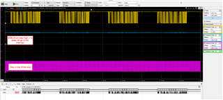

  • Hi Vince,
    it still not resolved. I changed the fifo interrupt level for SCI_FIFO_RX2 and SCI_readCharArray(SCIC_BASE, rData, 2);
    When I flash the program, sometimes it works, sometime it does not go to the interrupt.
    If I power cycle, it never goes to the interrupt.

    I am toggling two GPIOs, one un the interrupt and one in the while(1) loop.
    When it works you can see after two bytes received I am going to the interrupt.
    When it does not work, I think it goes to the interrupt one or two times then never go back, even if you can see there are some data coming in on the RX pin.
    I double check everything, compared to the example, could not see any reason why it would not go into the interrupt. I clear everything...

  • Hi Vince,
    No I configured the sensor to send 2 stop bits using their third party interface:
    My logic analyzer is also  configured in 2 stop bit and the data seems OK:
