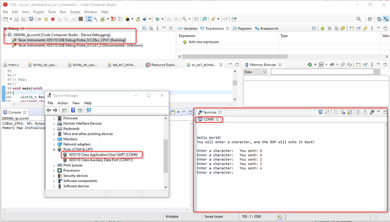

    Just to make sure, can you list the other COM port devices that get detected when you plug in the C2000 device? The reason I say this is that this sounds like something that would happen if the wrong COM port gets used (of the potentially 2 that are available on the debugger).
    Basically, depending on the device, there can be 2 COM ports that get broadcasted to the PC. For example, here's what happens when I plug in the F28004x LaunchPad into my Windows PC:
    There's two COM ports that are available, but only the first one (User UART) can be used for serial comms.
    If you see two, please try the other one and let me know if that works.

    I tried running the SCI loopback example on my F280049C LaunchPad. I connected a CCS Terminal program to the XDS110 UART and was able to successfully send/receive serial data
    You colleage has the target crash when they connect to the same com port on Windows 10?
