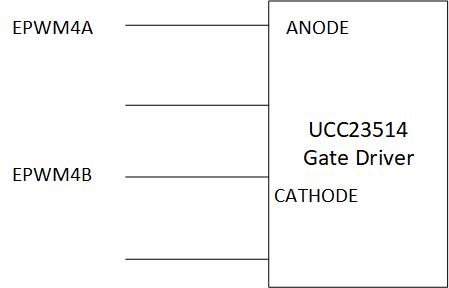

  • Hi Marlyn,
    I think I know the root cause now. I recorded the EPWM4A (Blue) and EPWM4B (Light Blue) when there is no over current in Fig 1.
    Because I configured it as active high complementary. It behaves as I expected.
    The strage thing happens when over-current occurs (Fig 2). Because CMPSS is taking the inductor current as the input, it will casue T2 event happen.
    EPWM4A is supposed to turned to LOW when T2 event occurs, but it doesn't.  EPWM4B is also not following the ative high complementary rule.
    Beaucse I connected EPWM4A and EPWM4B to gate dirver as Fig 3, the MOSFET only turns on when EPWM4A is high and EPWM4B is low.
    In this case, both EPWM4A and EPWM4B high will indirectly stops the MOSFET to turn ON, and inductor current will decrease.
    I don't see any example about using T1/T2 event to run cycle-by-cycle current control. Can you review my code in my original post to provide the feedback?
    I cannot use trip zone because I have to use the dead band generator.
    Kaiyu
    Fig 1  EPWM4A (Blue) and EPWM4B(Light Green) when no over-current
    Fig 2  EPWM4A (Blue) and EPWM4B(Light Green) when over-current
    Fig 3   Gate driver connection

  • Hi Marlyn,
    Here is the code. My concern is that the EPWM module seems not following the ative high complementary rule. It will make the half bridge shoot-through if I didn't put the hardware interlock.
    Kaiyu

  • Hi Marlyn,
    (1) I checked the trip zone function with the scope. When TZA goes to low and TZB goes to high, they happen at the same time, and there is no delay between then. I already see a lot of previous posts discussing this.
    (2) If I configured EPWM module active high complementary, it should follow the rule, but now I see both EPWMA and EPWMB go to high. This will cause catastrophic failure if there is no hardware interlock!!!
    Kaiyu

  • Thank you, Marlyn! I know there must be some other methods which could be used. It seems to me T1/T2 events cannot be used in this application for cycle-by-cycle current control. Coud you please confirm this? Is this the design imperfection for active high complementary when T1/T2 happens?
    Kaiyu
  • Hi Kaiyu,
    Yes, this is correct.
    T1 and T2 are inputs into the action qualifier but other events also programmed with the action qualifier submodule will occur if the right conditions are met. I don't think this is a design imperfection, this is just how the design was intended for T1 and T2.
