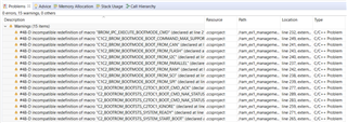

  • Hello Santosh,
    first when I build in CCS11 from C2000Ware 4.00.00.00 (latest version) the example ram_ex1_managemant_cpu1 I get 15 warnings. If I then change the linker cmd file to 2837x_flash_ink_cpu1, I first get the error that some areas are defined twice. If I then remove the cmd file stored in the project, the compiler does not find the split ram areas anymore, because they are not defined in the cmd. Unfortunately I can't find an equivalent shared ram cmd for the flash.

  • Hi Leon,
    I just imported the project and built for CPU1_RAM_DEBUG and CPU1_FLASH_DEBUG build configuration and I do not see any warning in any of the two configurations.
    What is the warning you are seeing? Can you post it the warning?
    Also, you should change the build configuration (right-click project,  Build Configurations -> Set Active -> CPU1_FLASH_DEBUG), then it will automatically include flash linker command.
  • Hallo Santosh,
    die Warnings bei RAM-Debug sind:
    Wenn ich versuche das zu Ändern habe ich keine Auswahlmöglichkeiten:

  • Hi Leon,
    Which project you are trying to import? Can you put the full path of the project? Also, can you send full build log in the console?
    I was trying :
    C:/ti/c2000/C2000Ware_4_01_00_00/device_support/f2837xd/examples/dual/RAM_management
  • Ok the program has only the warning that the program was written for another compiler. I had previously tested the example from the Online Resource Explorer.
