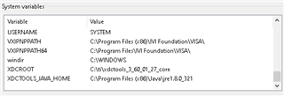

I'm trying to migrate a project from DSP/BIOS 5.42  to the latest SYS/BIOS 6.80. Also, move the project from CCS5.5 to CCS11. (Device used: C2000 - TMS320F28335).
I'm following the Application Report SPRAAS7G.
During the conversion of the Tconf configuration script to an RTSC Configuration Script using the terminal command XS as mentioned in section 2.4, I'm getting the following error.
C:\ti\xdctools_3_60_01_27_core>xs --xp "C:\ti\bios_6_41_04_54\packages" ti.bios.conversion -c myConfig.cfg --pr "C:\Users\gselvaraj\workspace_v11\V01199R18" --pn RTSCpackage -i tck.tcf
C:\ti\xdctools_3_60_01_27_core\xs: error: can't create session manager: create of JVM failed
I referred to the following posts in e2e forum, however, I 'm still not able to fix the above issues.
https://e2e.ti.com/support/microcontrollers/c2000-microcontrollers-group/c2000/f/c2000-microcontrollers-forum/915739/ccs-tms320f28335-rtos-xdctools_java_home-not-set-error-when-running-tconf-script-to-a-rtsc-configuration-script-conversion-tool/3387843?tisearch=e2e-sitesearch&keymatch=ti.bios.conversion#3387843
https://e2e.ti.com/support/tools/code-composer-studio-group/ccs/f/code-composer-studio-forum/706424/ccs-cc3200-xs-error-can-t-create-session-manager-can-t-find-a-jvm
this is my system variables screenshot
I tried with different XDC tools and different bios packages and still can't solve the error
