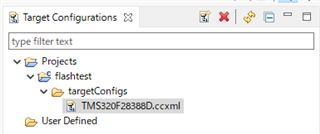

  • Hi Vamsi,
    I wasn't sure what the settings were, but I tried the following operations.
    1.Select "flashtest" project.
    2.Select "TMS320f28388D.ccxml".
    2.1.The setting contents of "TMS320f28388D.ccxml" are as follows.
    3.Open Properties of "TMS320f28388D.ccxml", Select Device->~Cortx_M4_0, Select "Flash Settings", Check "Reset on Connect" & "Enable Verbose Output"
    4.Push "Apply and Close"
    5.Launch "TMS320f28388D.ccxml".
    6.Select CM & Connect.
    7.Reselect CM & "Load Program..."
    8.Push "OK" -> Appear error message
    The operation result did not change.
    Masahiro
