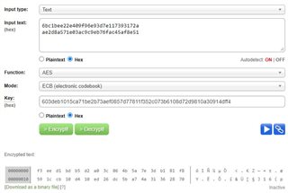

Dear Experts,

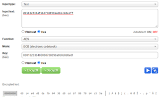

I use the same setup condition to verify that the output of the network tool and MCU encryption is not the same.
Mode setup: AES 128bit encrypt for ECB mode.
web tool url:aes.online-domain-tools.com/
MCU:TMS320F280039C and TI sample code(aes_ex1_ecb)
Why is the encryption of the AES module of the microcontroller different from the output of the online tool?
The encrypted output of the network encryption tool is as follows:
input data :{ 0x00112233, 0x44556677, 0x8899aabb, 0xccddeeff}
Key  :{ 0x00010203, 0x04050607, 0x08090a0b, 0x0c0d0e0f}
Cypher:{ 0x69c4e0d8, 0x6a7b0430, 0xd8cdb780, 0x70b4c55a}
MCU TMS320F280039C output encryption results as follows:
Cypher:{ 0xEEDB5AAD, 0x8361C787, 0x703A4E60, 0x8BB9165B}

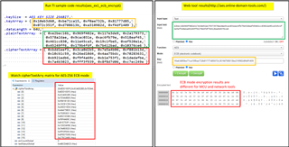

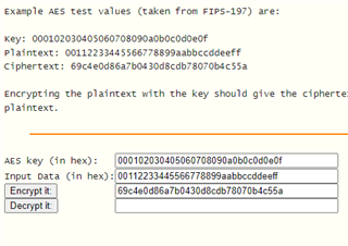

  • web tools url: http://aes.online-domain-tools.com/ or http://testprotect.com/appendix/AEScalc
    The two URLs are verified as follows
    The MCU are verified as follows

    Thanks for your reply. I redownloaded the TI sample code and did not change the code.
    Because the last for loop of the sample code does AES-256(Key) ECB mode for plaindata (64byte), I directly compared the MCU's AES-256 ECB mode with the encryption result of the network tool.
    The following comparison ECB encryption results are different.
    Environmental condition setting: ECB encryption mode , Key256bit, plaindata (64byte)
    plaindata =  e2bec16b969f402e117e3de92a179373
                        578a2dae9cac031eac6fb79e518eaf45
                        461cc83011e45ca319c1fbe5ef520a1a
                        45249ff6179b4fdf7b412bad10376ce6
    Key = 10eb3d60be71ca15f0ae732b81777d85072c351fd708613ba310982df4df1409
    LEFT = Run TI sample code results, RIGHT = Web tools results(aes.online-domain-tools.com/)

    Is there something wrong with my setup?
    Thanks for your help.
    I fed the data in the online tool which you referred. One change which needs to be taken care while feeding the data to the online tool is to swap the endianess of the data before feeding to the engine. The AES engine within the design expects the data in little endian format which is different from what the online tool is expecting.
    Once the data is converted and fed to the online tool, the cipher text started matching with what is provided in example. (please note that the cipher text output also needs endianess change while interpreting). I have put the snapshot below of the way the data is fed to the tool for your reference.
    Hope this helps. Please let me know if this response resolves your query.
    Thanks & Regards
    Pramod
  • Hi Vince
    Thanks for your help. Adjusting the bytes the way you said has been solved.
    thank you very much.
