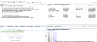

Dear C2000 champs,
I'm trying to use flash api to realize a custimized bootloader for F28035, but I have gotten in a trouble that the flash erase will be failed after device is reset, can you share your advice about this?
Here are the informations:
1. If using JTAG to program .out file into device and won't reset device this time, the erase and write to flash could works correctly.
2. If the device was reset, then the erase feature will be failed, the first fail address is always 0x003F0000, please see below picture.
3. The first input parameter in Flash_Erase function is 0xFE, that means the all flash sectors, except sector A, will be erased.
4. The retured value of Flash_Erase is 0x15.
5. The flash api has been copied from pflash to RAM at the begining of main, and runs in RAM. The function pointer(Flash2803x_Erase) is in ram location.
6. Here are my CMD file.

7. My initialiation code that copy flash to ram
     * Copy time critical code and Flash setup code to RAM
     * This includes the following ISR functions: epwm1_timer_isr(),
     * epwm2_timer_isr(), epwm3_timer_isr and and InitFlash();
     * The  RamfuncsLoadStart, RamfuncsLoadEnd, and RamfuncsRunStart
     * symbols are created by the linker.
    memcpy((uint16_t *)&RamfuncsRunStart,(uint16_t *)&RamfuncsLoadStart,
            (unsigned long)&RamfuncsLoadSize);
    memcpy((uint16_t *)&Flash28_API_RunStart, (uint16_t *)&Flash28_API_LoadStart,
            (unsigned long) &Flash28_API_LoadSize);
     * Call Flash Initialization to setup flash waitstates
     * This function must reside in RAM
    InitFlash();
Jack
  • Jack,
    I would like to make sure that the clock settings inside the API routine are correct, furthermore can you comment if you are using the internal oscillator for the main clock source?  This needs to be calibrated to have the correct/ in spec frequency to match the API expected frequency.  There should be a call to the Device_Cal function in your code.  The CCS connection will call this when the device is connected, so I'm wondering if that could be the issue.
    Another common problem is that the memcpy routine may be a C default vs the one we provide, I have seen this cause an issue.  Please take a look at the example we include in C2000Ware to see if there are any differences with the files you have included C:\ti\c2000\C2000Ware_4_01_00_00\device_support\f2803x\examples\c28\flash_programming
    I've also attached a copy of the API user guide, one feature we have on the F2803x is that we have embedded the API code into the ROM of the device, so that you do not need to store it in API and copy it to SRAM like on the older devices.  I would also try this as it will eliminate the potential for the memcopy to be in play.

    Thanks for support here, I figured out that the variables, Flash_CPUScaleFactor and Flash_CallbackPtr, didn't initialize in my code. After initialized those 2 variables, this issue is gone.
    Regarding to memcpy routine in C default, what issue you've seen? Can you share more details about it?
    Jack
  • Jack,
    It doesn't happen often, but I think there is a C standard memory copy that is slightly different than the one we use in our examples.  I could be mis-taken here, it was a one time E2E post sometime last year.  If everything is working you are fine.
    Matthew
